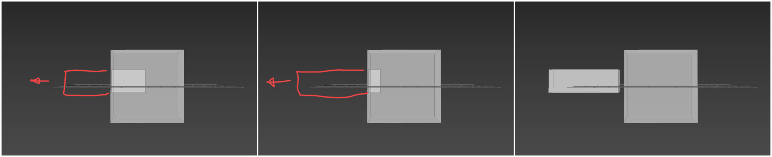

    When I apply a tyboolean modifier (intersection) to 2 cubes it works fine.
But as soon as there is no more intersection between the 2 cubes then the original cube reappears.
Is there any way to keep it invisible?

Does this happen with the latest build (v1.028)? I thought I fixed this bug a while ago and I can't reproduce it anymore...
(10-05-2023, 01:08 PM)tyFlow Wrote: Does this happen with the latest build (v1.028)? I thought I fixed this bug a while ago and I can't reproduce it anymore...
This unfortunately keeps happening with the latest build. Perhaps it is due to the use of final toon as the render engine.

Ah, I missed that you're in intersection mode. That'll be why, and is likely a bug then. I'll make a note to look into it.
