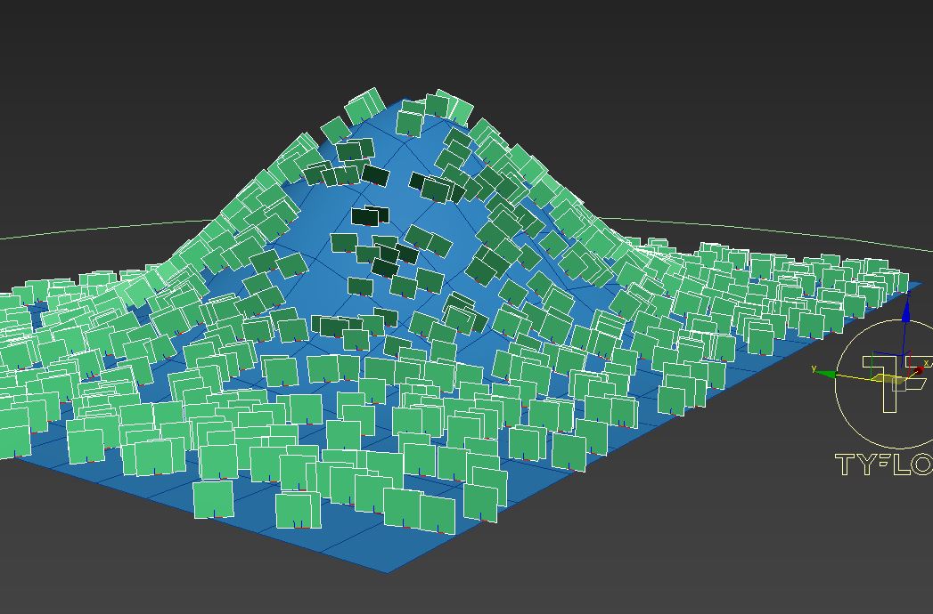

I'm getting a strange result here though. Is the attached image how it's meant to be? The trees are aligned to the surface normals, not vertical world z.
I thought you wanted them to be aligned to the surface as well.
If not just set forward axis to world (0,0,1).
Thanks. That's what I did to get the result. Although I still can't figure out why I had to rotate them -90 on Z.
