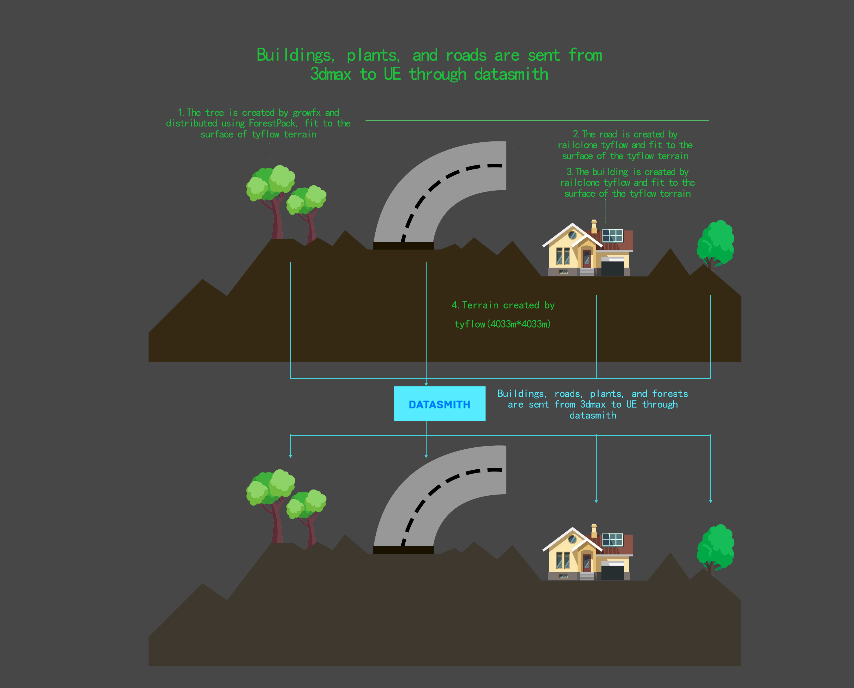

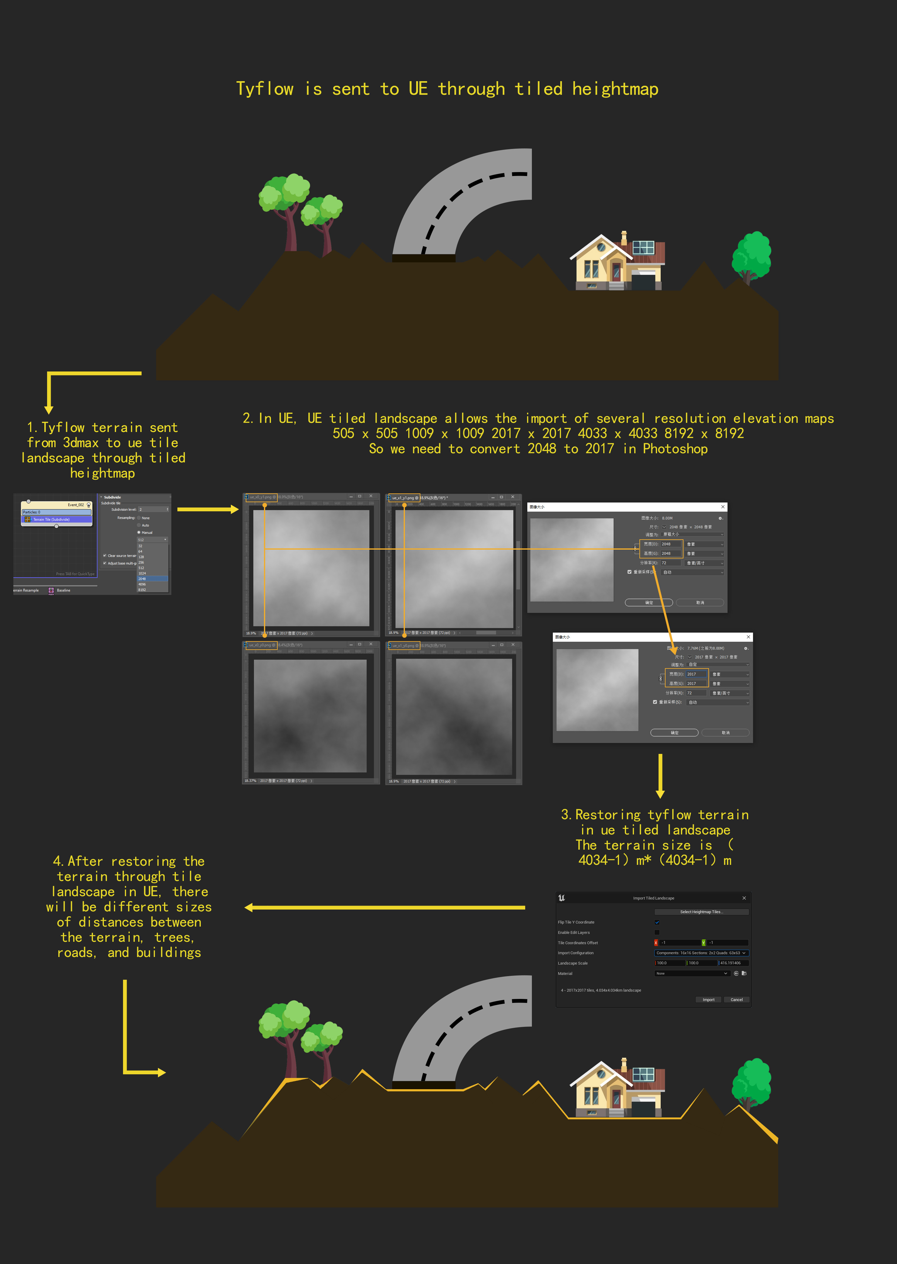

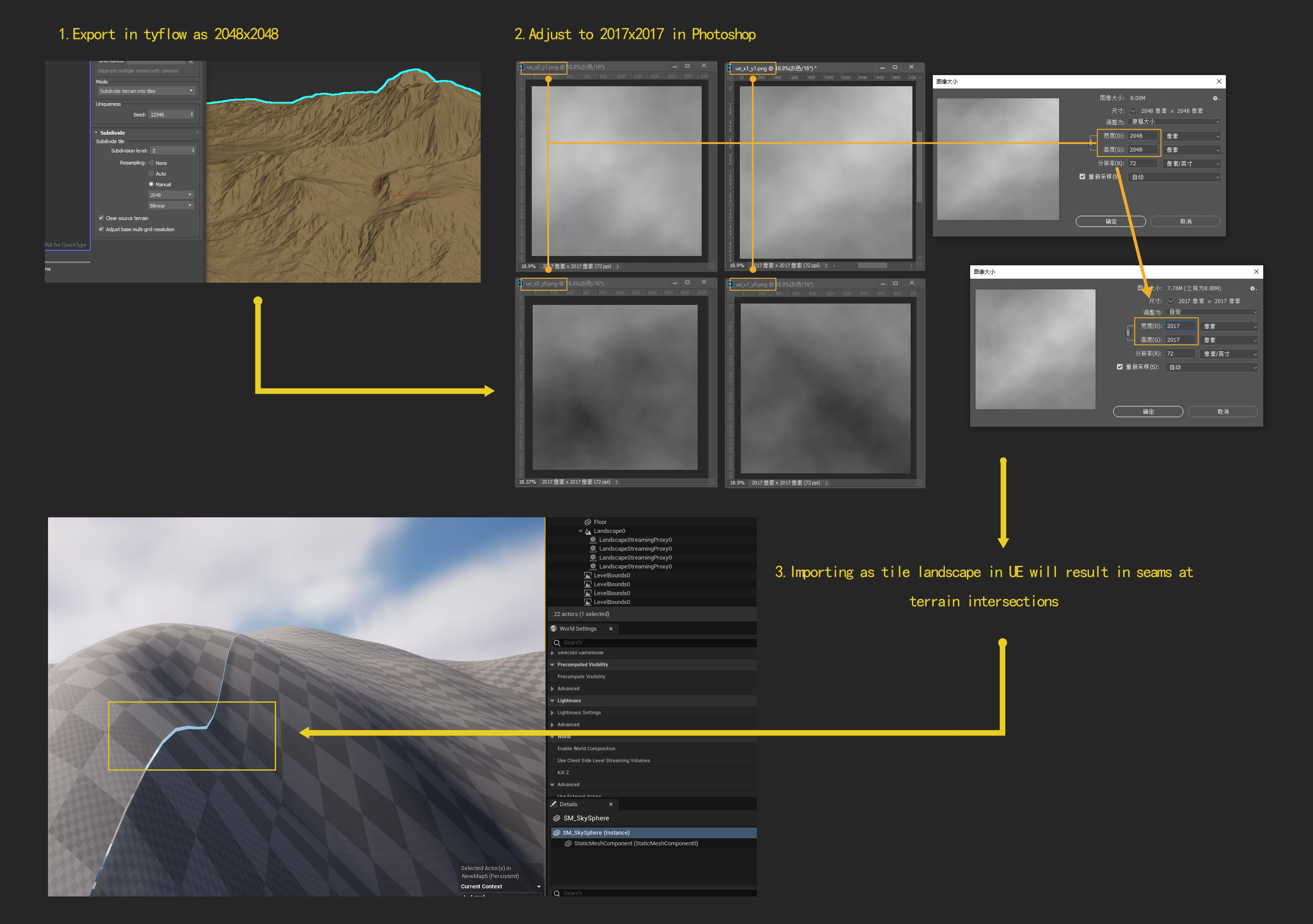

Perhaps it was unclear from the previous statement, so I will give a new example
Game Terrain, Game buildings from 3dmax to ue V2

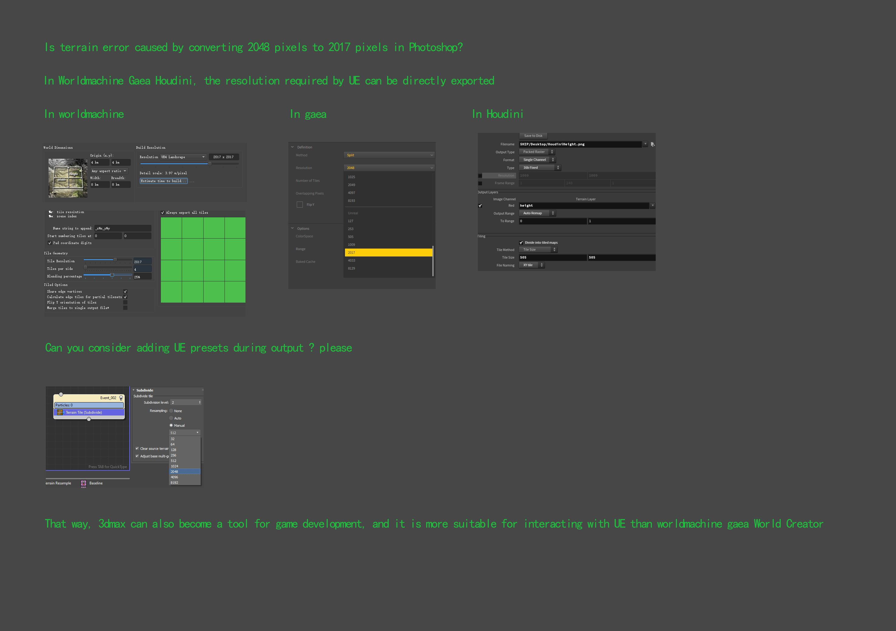

Thank you for the informative images. Can you clarify: if you export a terrain from tyFlow (ex: 2048x2048) and then resize to the desired UE dimension (ex: 2017x2017), everything works in UE? And you're just asking whether or not tyFlow can natively export at UE resolutions? Or is there an issue resizing the terrain afterwards as well?
