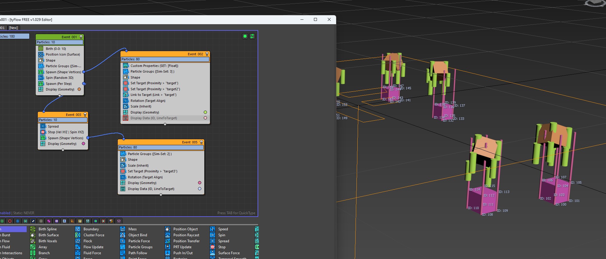

Hi, just a quick question ( probably)
Im trying to get a sort of piston rig going - with two events looking at eachother.
For event 1 -  I set the target to proximity and filter the particles by simulation group < - this works fine.
For event 2 - I try to do the same thing but that doesnt work, I guess this has to do with event evaluation priority ?
Is there a workaround or better way to do this ?
Both particles must exist prior to entering the Set Target event in order for them both to receive a valid target. Also make sure your various operators (ex: Rotation) are referencing the correct target channel.
See attached.
