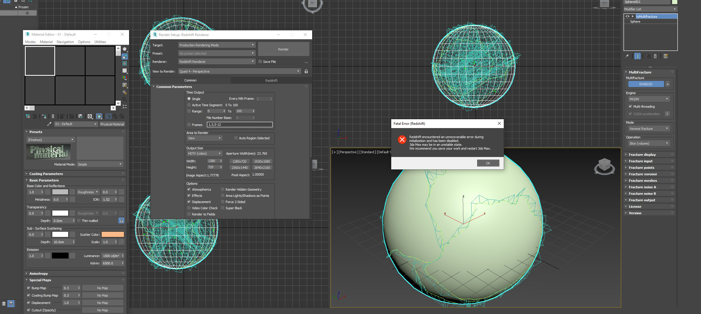

I've just started getting Redshift throw an error when adding multifracture to an object - not sure if it's a TyFlow bug or a Redshift one?
Seems easy to reproduce, just create a sphere, add a tymultifracture and open up the standard material editor while Redshift is the renderer
Just an update - even if I collapse the multifracture stack, it still crashes.
I rolled back to the version before TyDiffusion was introduced and it no longer crashes - if that's any use...
Here's the redshift crash log too
