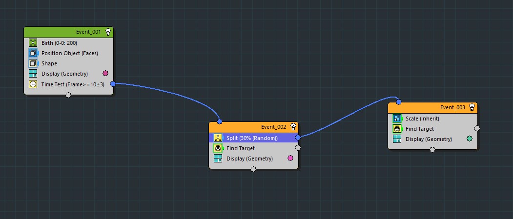

I have a project where I'm using Tyflow to morph between different objects. My client wants the amount of particles reduced on the second object, but I can't work out what I need to do.
Imagine there is a sphere made up of 200 particles on the left that needs to become a box of 100 particles on the right. I can figure everything else out, but not how to get the particle amount to reduce over the travel time between events.
Any ideas?
Thanks,
Andy
Ah, I think I've got it. Keeping things simple helps. I was trying to solve it in my big, complex scene, but test results are quicker in a fresh scene. I used a split node to make a percentage of the particles reduce in scale to zero over time. Hopefully, that'll do the trick!
