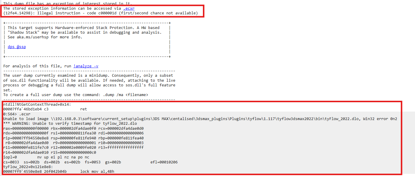

Yep, I have attached image of a possible reason

Hmm, it's crashing in a very bizarre location, which makes me think that some other memory corruption is happening and the location in code the memory dump is pointing to is a symptom not the cause.
Could you send me a few minidumps from a few separate crashes? That way I can check if they all point to the same location or not (the latter would confirm my theory above). So like, 4 or 5 separate dumps from separate crashes, if you have them.

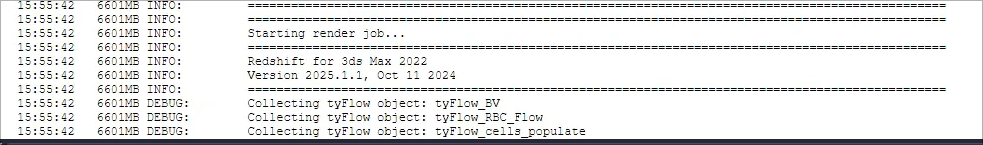

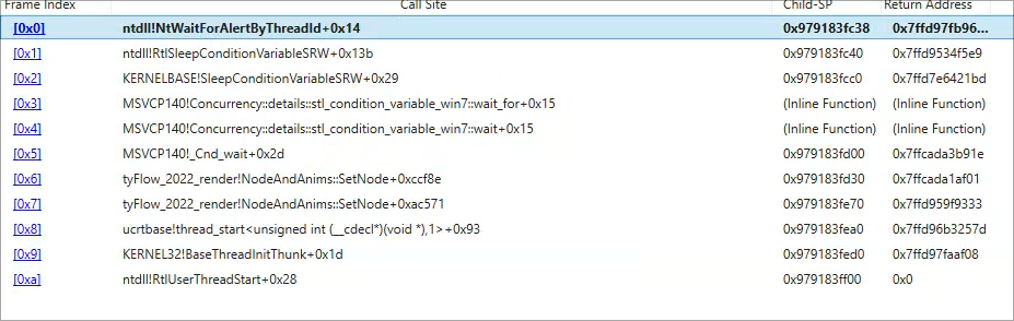

Our pipeline dev has been trying to debug it the last couple of days and they've attached to the process using WinDbg and managed to get a somewhat consistent stack trace, paired with the Redshift log cutting off early - while loading Tyflow objects from a certain setup. Please see images attached.
We're not really sure if tyFlow is the cause, but would appreciate any guidance, hopefully, something screams out to you from the images. (Note it's always the two tyFlow_2022_render!NodeAndAnims::SetNode+ at the same memory addresses if that means anything to you)
I would need to see the minidumps to investigate further.
