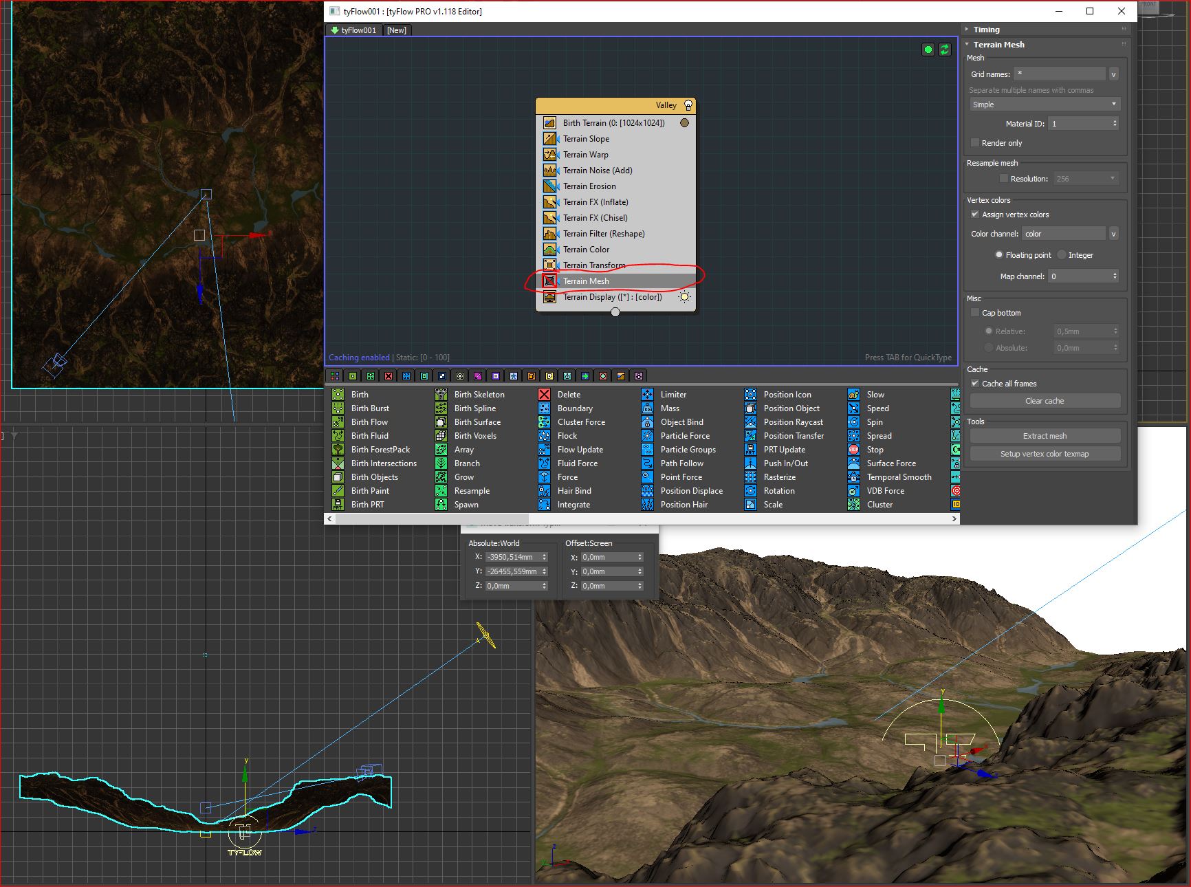

Now I wonder, why my renderings look like this. This started after I updated to V-Ray 6. tyFlow particles are working normally. It was this before I used the Terrain Transform operator. So this didn't cause the issue.
Ai asked AI about this problem (I don't share the answer here because it's in Finnish). However I have already checked every scenario in that answer and found nothing. How about others, is the terrain rendering correctly with V-Ray6?
Did you forget a Terrain Mesh operator?
Thanks,

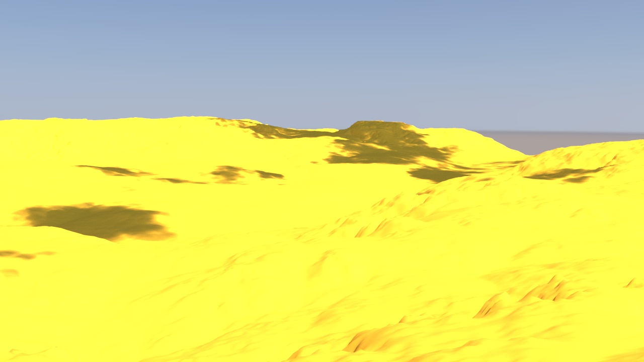

I added the Mesh operator and the rendering now looks like this.
I really don't know what I'm doing wrong here. What do I need to do to get similar terrain mesh than in viewport.
#8
Use a Terrain Export operator to export your color maps, then apply those in a material to the mesh.
#9
Thanks,
Now it renders, but it's completely flat. What should I try next. I have a client asking, why I'm not advancing. What should I answer?
I got it now. My logic works a bit differently than normal human beings, so I accidentally adjusted wrong parameter.

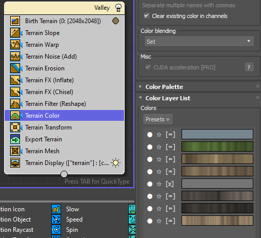

Few more things,
About the color operator. I'm not quite sure on how it works. I want create a shoreline, where the water is made by Chaos Phoenix FD at 0-level. Now, what should I do if I want rocky and sandy waterline?
I have used Valley and Grassland ridges presets.
I don't want to post any screenshots of the actual model.
#11
I think I got it now. Whenever I change the topology, I need to regenerate the color operator.
