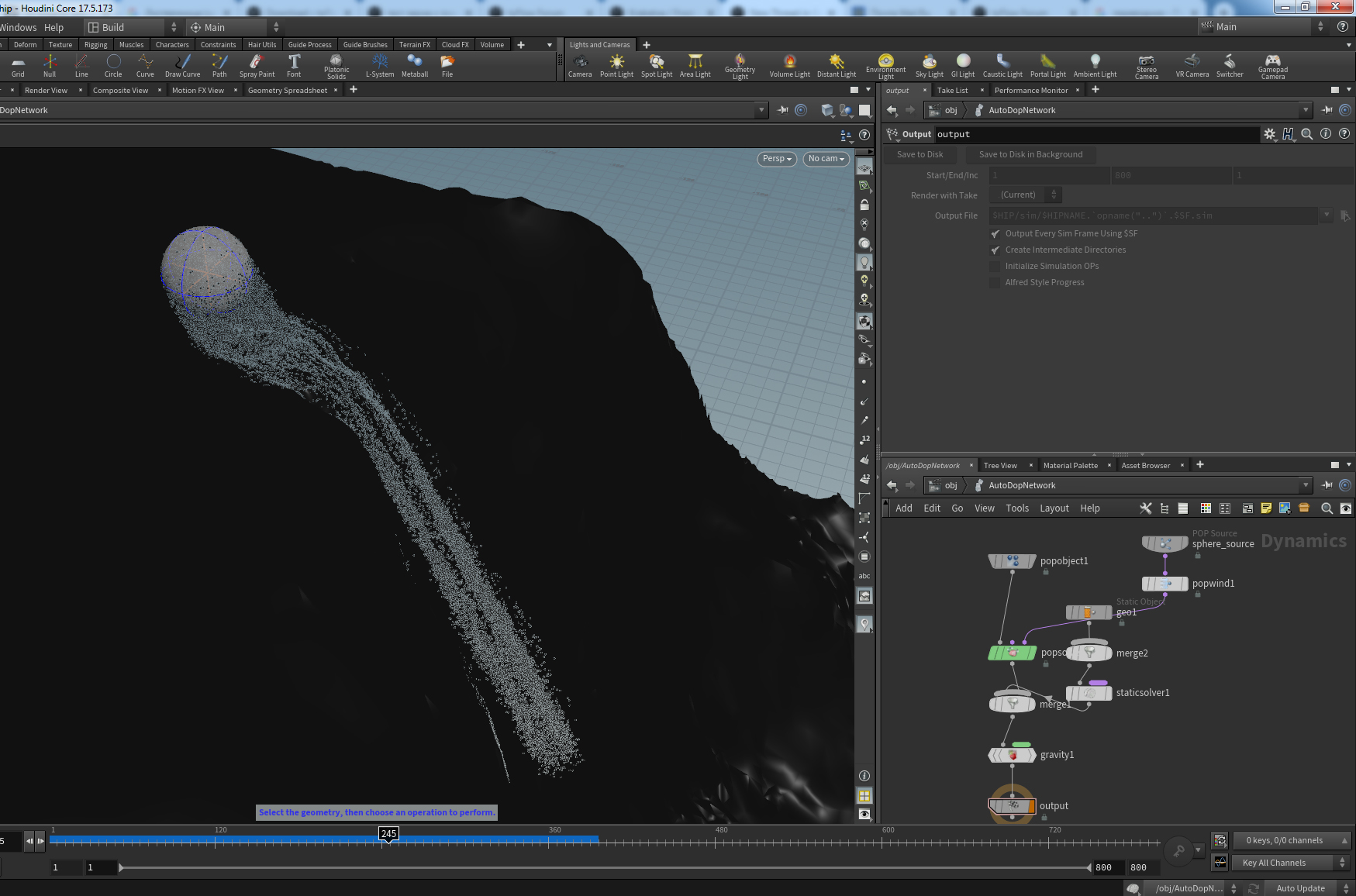

I wanted to play around with the waterfalls .. are there any ideas for this in TyFlow ? I don't need to water mesh, it is quite enough to generate particles..
For example, I have a simple example in Houdini, do not quite understand how to repeat with TyFlow in the same way?
Any help is welcome!
(Particles generation only)

There are no liquid emitters (In Houdini), this is the usual particle system..
