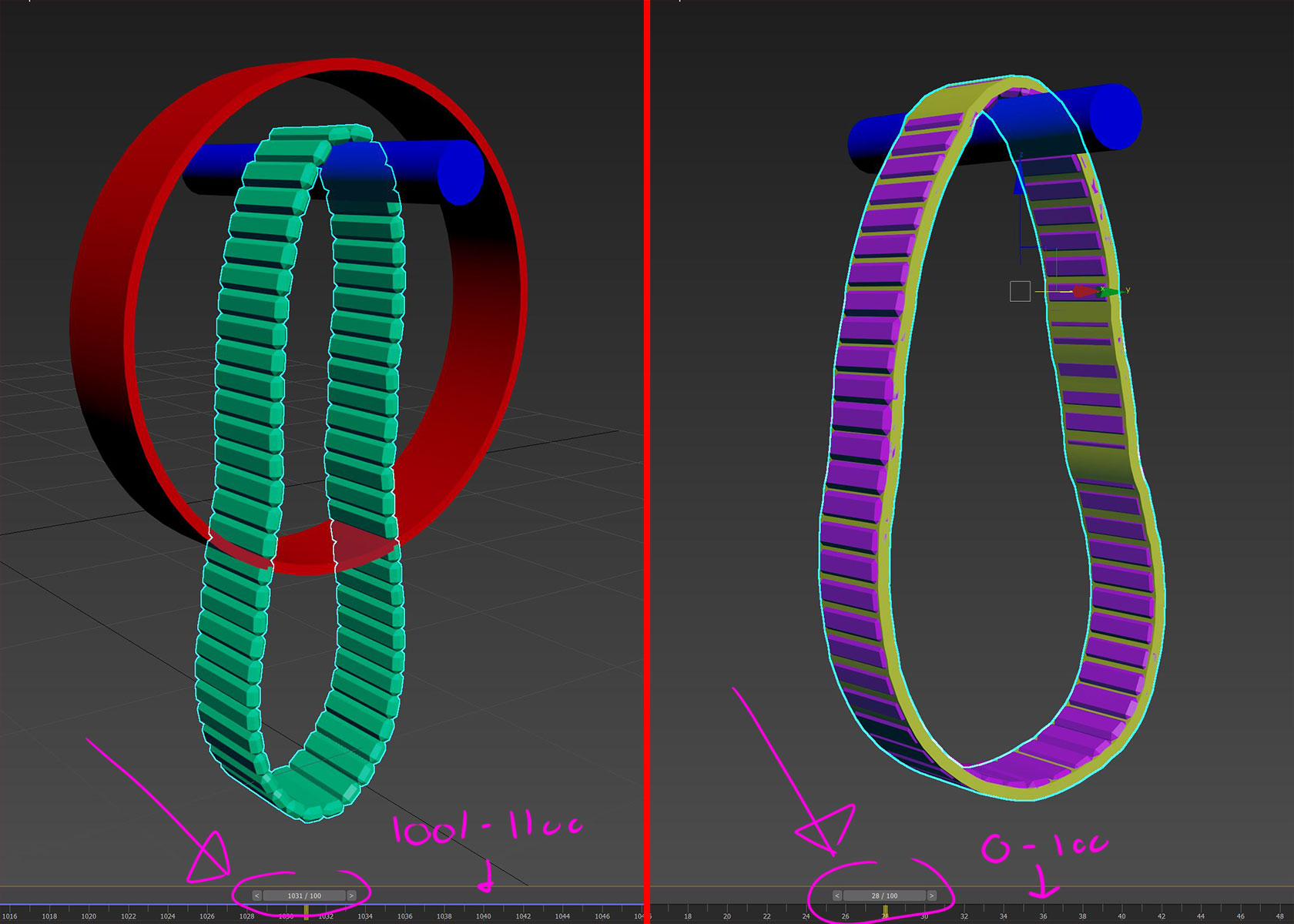

I think I found a small bug in TyParticleSkin or maybe I’m misunderstanding something.
If I start 3ds Max with the timeline set to 1001–1100, the TyParticleSkin doesn’t seem to do anything. But if I use the 3ds Max default timeline 0–100, it works just fine.
I was going crazy
trying to figure out why TyParticleSkin wasn’t working in my scene.
I checked some shared scenes on Facebook, and they all worked fine.
So, for a couple of hours, I basically went through every setting in TyFlow, but nothing worked.
Then I noticed the difference in the timeline, my max starts default with 1001–1100. when i switch it to start at 0 every thing was fine.
But wanted to flag this also for others.
Image is the is simple physX setup and the same setup. diffrent timeline. first with 1001-1100
