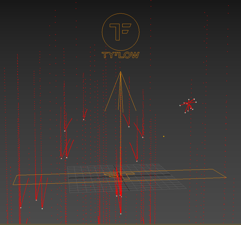

I found, that in my Scene when I am at timepoint 28:38 in the Video, my particles after lowering the Velocity / Inherited % Value they behave mostly still as straight lines instead of getting a balistic flying style, except just 2 Particles, wich show this desired effect - and that also only in quiet incorrect way.
Buildversion of Tyflow used by the Guy´s Tutorial there is couple of month older. I am using the lates here.
The Effect appears only from frame 465 on. I am almost sure, I did same things like the Tut was showing up (hopefully.... =)

When I open your scene file and play it through, I don't see anything that resembles the screenshot you posted. Are you sure you posted the right file?
(07-16-2019, 06:56 AM)tyFlow Wrote: When I open your scene file and play it through, I don't see anything that resembles the screenshot you posted. Are you sure you posted the right file?
Well - indeed...
First, I was playing around with this scene on my Laptop (with i7 Processor and a Quadro K2000. For some exercising purpose thought might be good enough)
So maybe thats a missing nVidia Physics thing, thats missing an that kind of chip.
I encountered on my Workstation now, that I probably see what you see - so the red trails are not visible anymore - wich had been displayed wrong on my Laptop. But also non of the Ballistic motion. I go through the Tutorial again and see what happens. So the Case, that the trails are not moving nicly in a ballistic curve, might be still a problem on my side.
EDIT: at least I can say, that it was hardwares fault. I loaded some testscenes from you inside and haven´t encountered any displayproblems ( ok it was sloooow)
Dontknow, why it was differing so much between diffenrent Machines
