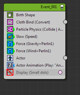

edit #2: i think i'm missing something. sorry for reediting, this is making me nuts. i have a plastic bag that i want to act like a cloth - with all the forces applied slowly floating upwards.
at the same time, i want the bag shape to be overall animated. i've done that with making it a tyactor.
tyflow doesn't seem to take the animation into account. i've attached my 'flow'
Did you enable non-skin deformations in the tyActor settings?
(07-31-2019, 05:22 AM)tyFlow Wrote: Did you enable non-skin deformations in the tyActor settings?
after i read the documentation back and forth Big Grin i actually did _ anyways still no animated movement whatsoever.

can i turn an animated object into a cloth bind (and also put some forces on that cloth object)
And you also made a proper animation clip, which you're playing with the Actor Animation operator?
If the problem persists, please upload the scene file.
