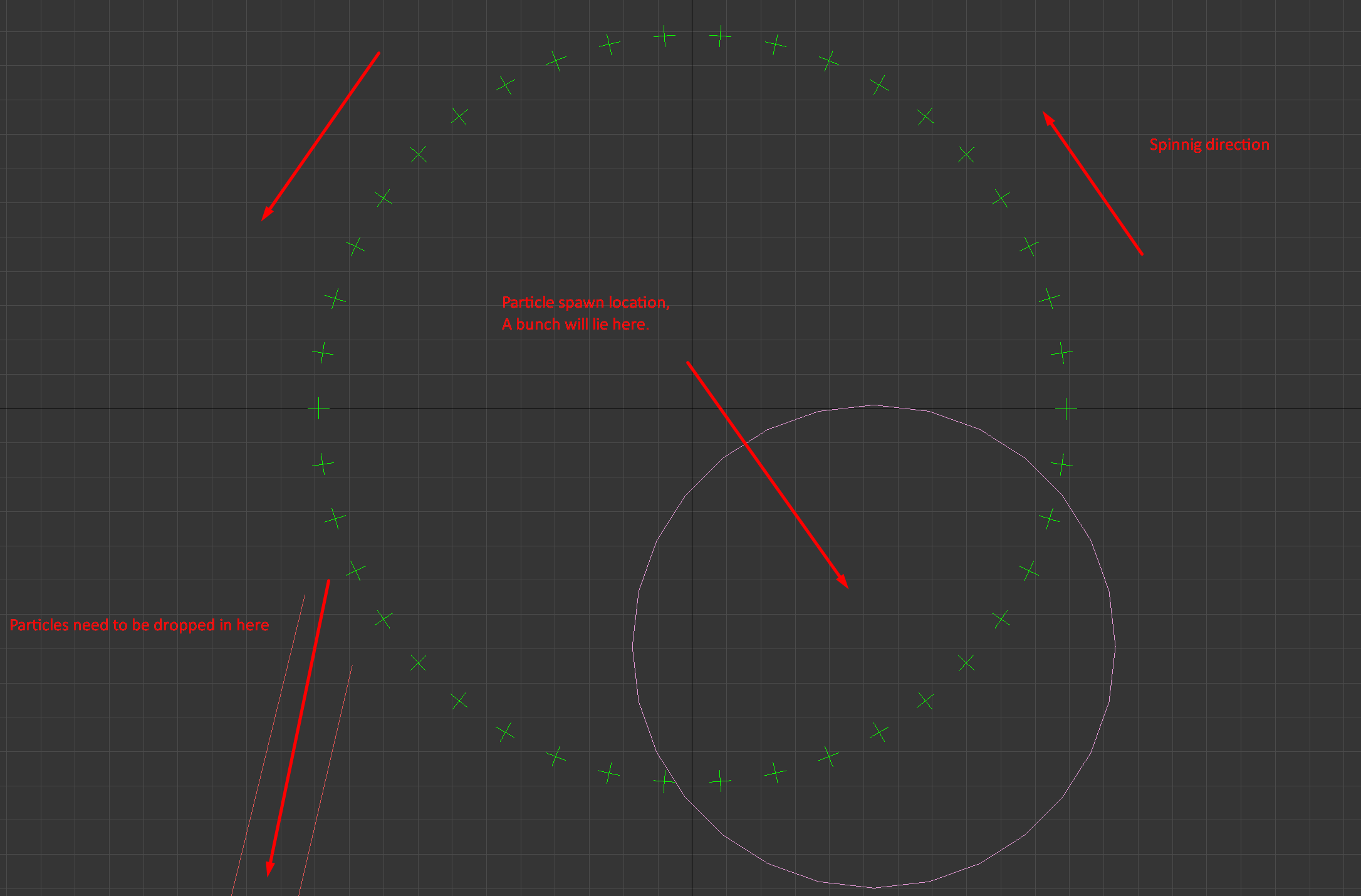

I've got a place where a bunch of Particles will lie around (the purple circle)
Then the wheel (green helpers) picks them up one by one.
One particle per helper. And then they need to get dropped into a tube.
How can I make this happen?

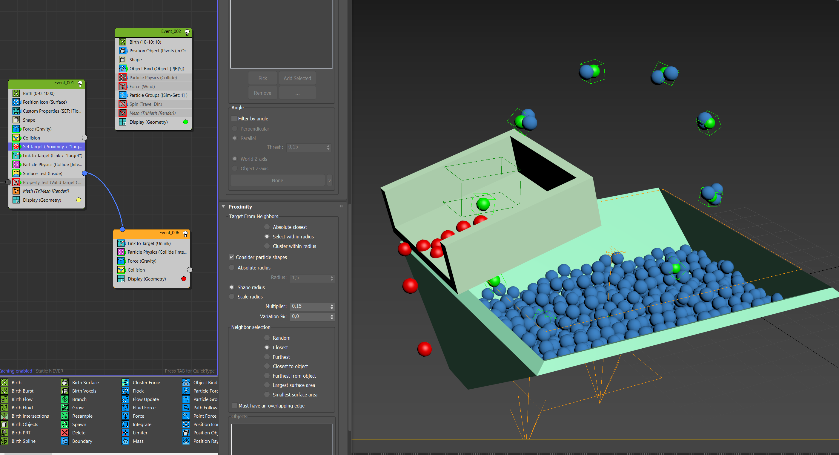

This is what I've got now:
It works quite well but I'm struggling to control how many blue particles can get linked to the green ones.
There should be at least one and max two particles linked.
I can control it by shrinking the radius of the set target operator.
But below some point I'll get green particles without blue ones and still some with more than 2.
Also, the first linked particle should sit exactly on the position of the green ones but the second should stick to the surface of the first one.
I was trying to use the Move to Target operator but it doesn't seem to do anything I think I'm doing something wrong.
When I use the Move to Target checkbox in the Set Target Operator, every particle will have the position, so when they hit the green box and get pushed into the next event they kind of explode into multiple red particles.
I dont know what you mean by "de-activate particles" how would I do that?
And last but not least, I'd need to be able to know which are the second linked particles to be able to unlink them and let them fall back into the pile. Like in the example above.

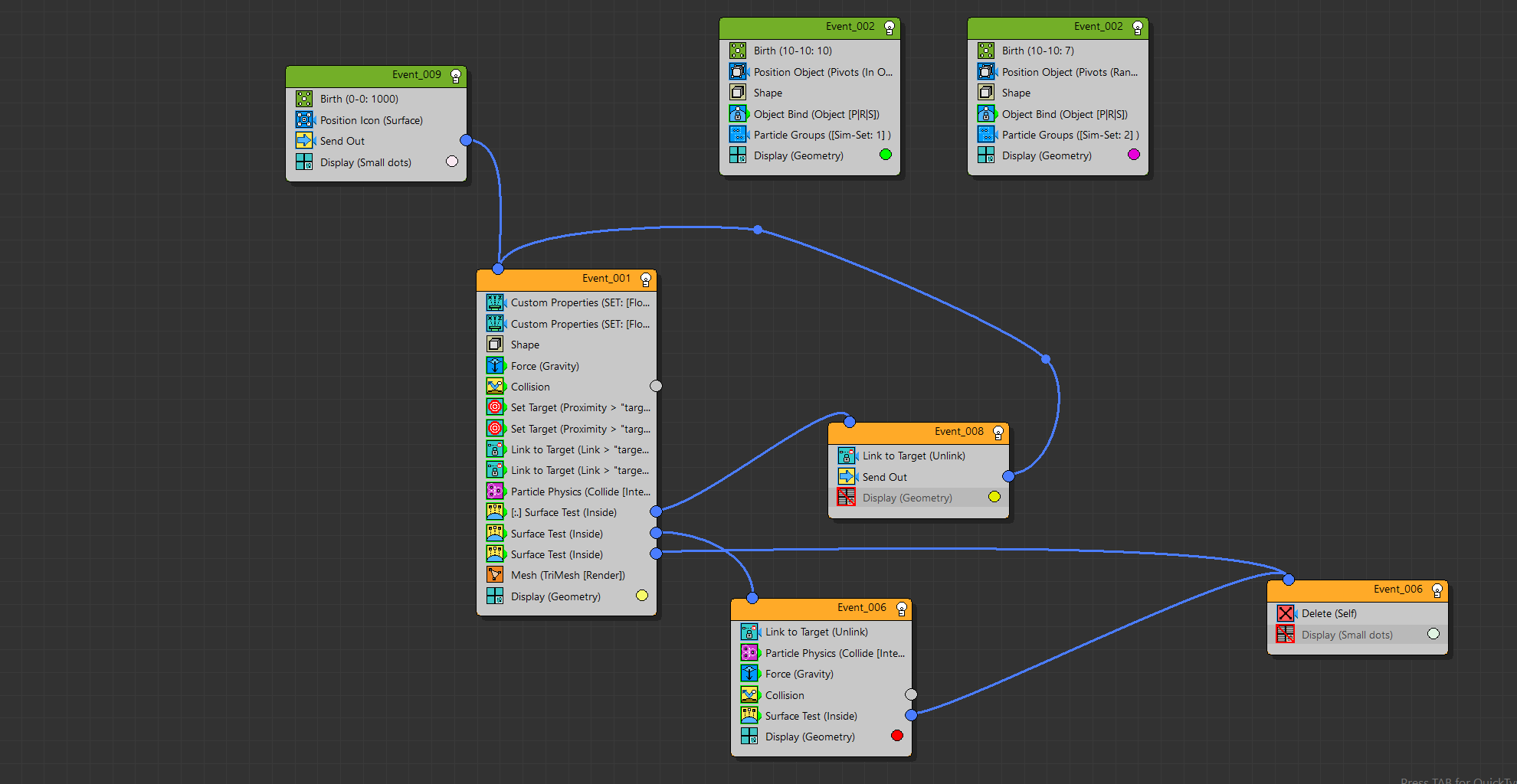

I finally managed to make a working and scalable version!!
It looks like this:
In case somebody needs it sometime, here is the final RnD scene:
(Max 2020)
.zip   Tyflow_WheelLinkingFinal.zip (Size: 66.31 KB / Downloads: 372)
Thanks a million for this plugin!!
While this works, it's a pain to set up for the production scene.
The reason is the way I limit the amount of blue particles that can be linked to the green ones.
Its collision based.
The radius for the set target is smaller than a particle, so as soon as a particle is linked, its radius will prevent other particles from getting in the set target radius. But that's quite error-prone since it depends on the time steps and particle shape.
When the set target radius is too small I get empty green particles. If it's too big on the other hand, I get multiple linked blue particles per green particle.
And I always have to sim quite a bunch of frames to test if I hit the sweet spot.
Is there a way to limit the amount of linked particles per parent particle to one? That would make everything much easier!
And another Question: When I use PhysX particles with this setup. Do I have to raise the time steps or the PhysX substep to ensure the collision is called often enough to prevent other particles from geting in the set target radius?
EDIT: I can't make it work with physx: Either I get empty green particles or more than one in one . At least I have a fallback with none-regular particles.
