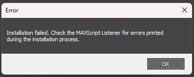

i have the same error and i have the 4090 GPU.
i hope @tyFlow can fix it.
Thanks for your help @tyFlow ..  Angel Heart

Did you accidentally enable the DirectML checkbox in the tyFlow UI before installing?
Turn on file logging in the Setup > engine > advanced tab and run the one-click installer again, with DirectML disabled - then post the log so I can see if Torch installed.

Could it be a firewall thing?
These work pcs have a lot of website restrictions, if so, can I download it in another pc and copy paste it on this one?
Thanks for the help!
.txt   setup_ComfyUI.bat.log.txt (Size: 110.88 KB / Downloads: 1,037)
.txt   setup.bat.log.txt (Size: 18.57 KB / Downloads: 193)
#29
Can you keep logging enabled and also attempt to generate an image as well? That will generate a log called "run_ComfyUI.bat" as well, which I'll need to see too.

#31
Check that the file being reported in the last line of your log exists - if it doesn’t, the one-click installer failed for some reason (connection or permissions issue)…if it does, it’s likely a permissions issue. Way to solve both is to run Max as Administrator and run the one-click installer again. Also make sure you have enough space on the target drive (10-15 gigs)
#32
(08-13-2024, 12:18 PM)tyFlow Wrote: Check that the file being reported in the last line of your log exists - if it doesn’t, the one-click installer failed for some reason (connection or permissions issue)…if it does, it’s likely a permissions issue. Way to solve both is to run Max as Administrator and run the one-click installer again. Also make sure you have enough space on the target drive (10-15 gigs)
Yes, I run 3D Max as administrator.
More than 100 GB of free disk space
Oh, it seems to work))
Thank you!

Hi, I have followed the instructions but am still having a problem. Huh
- I have an updated graphic card driver
- Enough space on C drive
- Checked "Enable install/engine file logging"
- and running 3Dmax as an administrator
Please advise,
Thanks!
.txt   setup.bat.txt (Size: 11.55 KB / Downloads: 223)
.txt   run_ComfyUI.bat.txt (Size: 3.77 KB / Downloads: 210)
.txt   setup_ComfyUI.bat.txt (Size: 9.73 KB / Downloads: 180)
#38
Python didn’t install correctly and your log shows an internet connection issue in a couple places.

(08-28-2024, 12:45 PM)tyFlow Wrote: Python didn’t install correctly and your log shows an internet connection issue in a couple places.
I’ve installed Python 3.12.5. Does it fit?
Yes we have internet restrictions at the office, could you let me know what specific access I need? I’ll make sure to request it from the company and then try to install the diffusion again.
Thanks for your help!
#40
You would need to ensure Max has full internet access during the tyDiffusion installation process.

Thumbs Up
(08-28-2024, 02:52 PM)tyFlow Wrote: You would need to ensure Max has full internet access during the tyDiffusion installation process.
It has been installed after getting full internet access, thank you!
