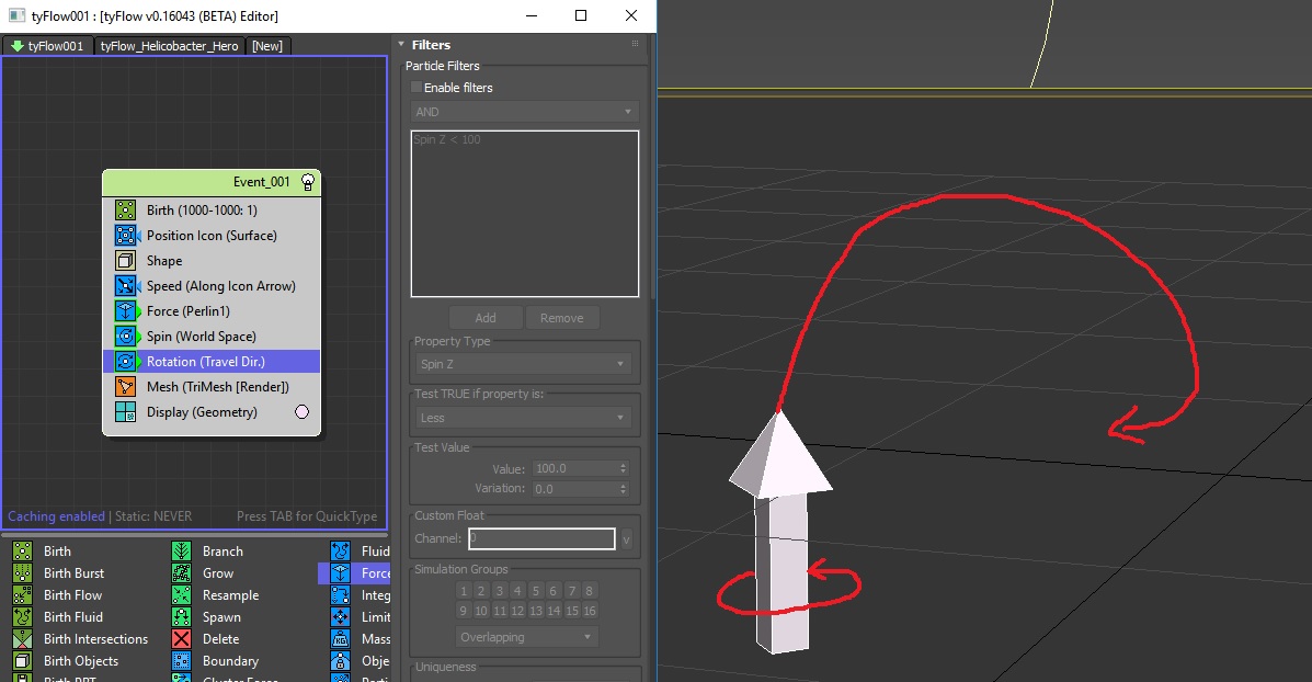

Lets say I wanna animate some particles and use travel direction to have them rotate towards their velocity vectors. Why is it not possible to add a spin operator on top to have them spin on their local axis, while rotating towards their travel direction? Like arrows, that also spin while they travel...
I feel like this should be possible, yet I couldn´t make it work.

I'm facing exactly the same thing, spin and rotation by travel direction cant work together.

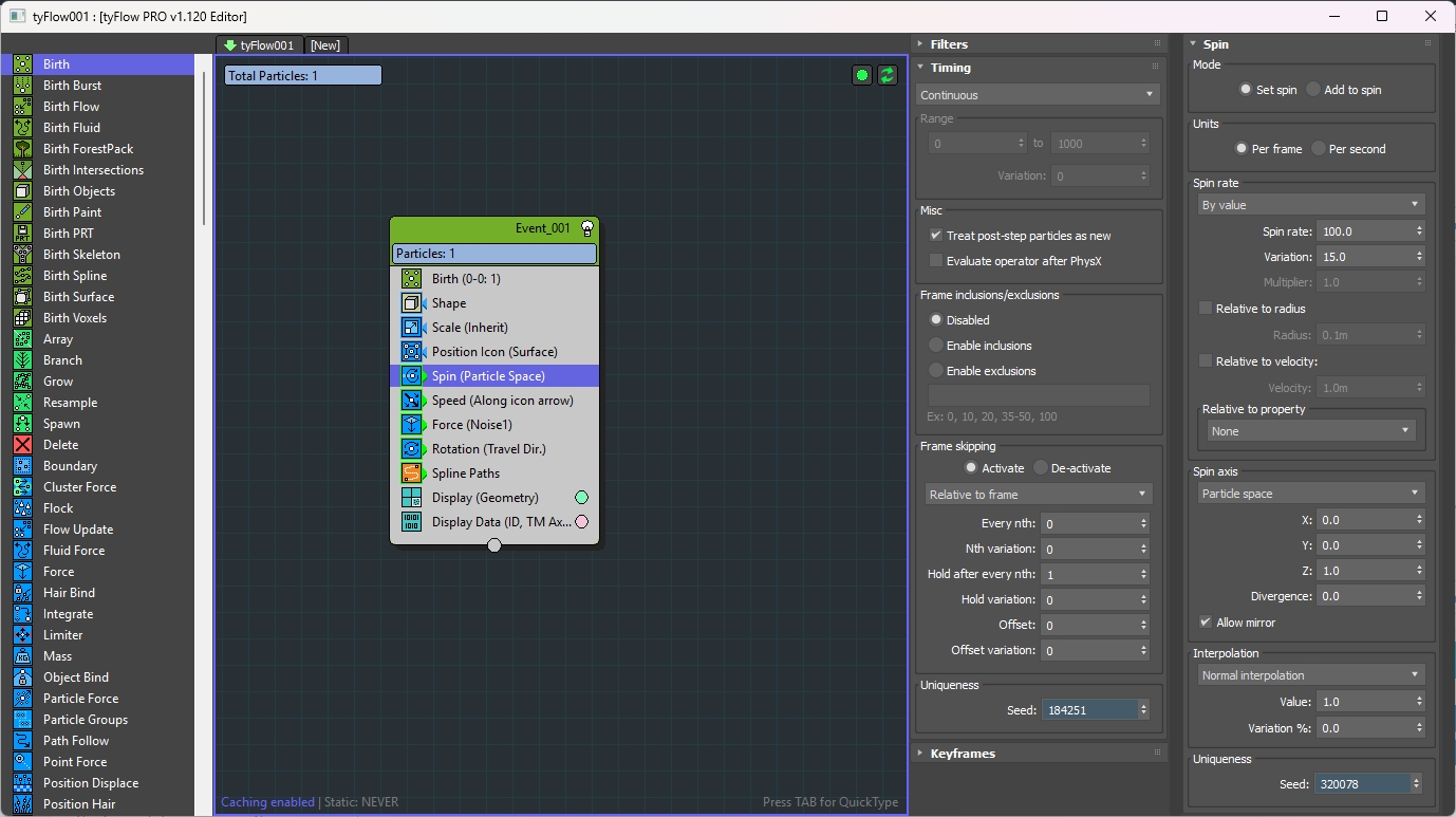

Hi guys, hope it'll help!
.mp4   tySpin+RotateTD.mp4 (Size: 1.52 MB / Downloads: 115)
.max   tySpin+RotateTD.mp4.max (Size: 492 KB / Downloads: 105)
