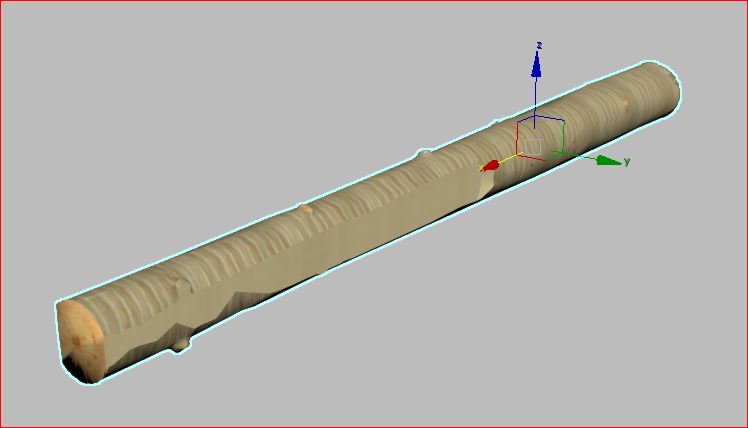

I wonder if TyFracture would be correct tool for chipping a log sides. I have normally done this by using boolean or V-Ray slice, but then I would need an additional particle system and don't see the log being cut. I modeled this log mid 90's by using Digimation's Clay Studio Pro metaspline and have used it in my sawing animation ever since.
So I'm looking a way to permanently reduce geometry as log object passes the blades.

If you need to perform successive cutting operations, you can use the Boolean particle operator in the latest build. Import your object with a Birth Object operator, then use a Boolean operator (with Timing set to "continuous") to perform multiple subtraction operations on it over time using your cutting geometry. See attached.

I used the tyFlow modifier workflow. What is the main difference to this. In my workflow, there is a stationary operand which reduce geometry once it passes the object. The particles are made with tyFlow particle system. When suggesting the multifracture workflow, I thought it would be cool to see how the blades cut pieces from the log.
Anyway, the client already likes what I have done. Minor inconvenience is that there's some flickering at some frames. It's gone when I move the cutting operand just a tiny bit. I just don't know that before rendering a sequence.
